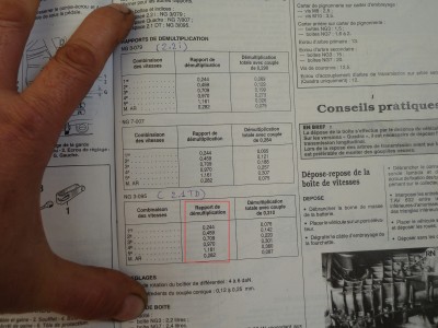

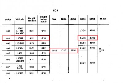

Je n'avais pas l'intention de m'immiscer en intrus dans cette histoire de boite, ni de savoir laquelle tirait le plus long, mais je crois que je suis d'accord avec [b:052d2da2c3]TheStone [/b:052d2da2c3] et [b:052d2da2c3]Totor33[/b:052d2da2c3] : c'est une histoire de coupe... peut...le.
[b:052d2da2c3]2,2i[/b:052d2da2c3]
[table:052d2da2c3]
[mrow:052d2da2c3] NG 3/079 [nbsp:052d2da2c3][nbsp:052d2da2c3][mcol:052d2da2c3] Boite [nbsp:052d2da2c3][nbsp:052d2da2c3][mcol:052d2da2c3] Couple[nbsp:052d2da2c3][nbsp:052d2da2c3] [mcol:052d2da2c3] Dem [nbsp:052d2da2c3][nbsp:052d2da2c3][mcol:052d2da2c3] Pneu en m[nbsp:052d2da2c3][nbsp:052d2da2c3] [mcol:052d2da2c3] Parcours [nbsp:052d2da2c3][nbsp:052d2da2c3][nbsp:052d2da2c3][nbsp:052d2da2c3][mcol:052d2da2c3] Vitesse en km/h
[mrow:052d2da2c3] [mcol:052d2da2c3] [mcol:052d2da2c3] [mcol:052d2da2c3] [mcol:052d2da2c3] [mcol:052d2da2c3] en m/tr [mcol:052d2da2c3] à 1000trs/mn
[row:052d2da2c3]1ère [col:052d2da2c3]0,244 [col:052d2da2c3]0,290 [col:052d2da2c3]0,071 [col:052d2da2c3]1,85 [col:052d2da2c3]0,130906 [col:052d2da2c3] [nbsp:052d2da2c3][nbsp:052d2da2c3]7,854
[row:052d2da2c3]2ème[col:052d2da2c3] 0,459 [col:052d2da2c3]0,290 [col:052d2da2c3]0,133 [col:052d2da2c3]1,85 [col:052d2da2c3]0,246254 [col:052d2da2c3]14,775
[row:052d2da2c3]3ème [col:052d2da2c3]0,709 [col:052d2da2c3]0,290 [col:052d2da2c3]0,206 [col:052d2da2c3]1,85 [col:052d2da2c3]0,380379 [col:052d2da2c3]22,823
[row:052d2da2c3]4ème[col:052d2da2c3] 0,970 [col:052d2da2c3]0,290 [col:052d2da2c3]0,281 [col:052d2da2c3]1,85 [col:052d2da2c3]0,520405 [col:052d2da2c3]31,224
[row:052d2da2c3]5ème [col:052d2da2c3]1,161 [col:052d2da2c3]0,290 [col:052d2da2c3]0,337 [col:052d2da2c3]1,85 [col:052d2da2c3]0,622877 [col:052d2da2c3]37,373
[row:052d2da2c3]Marche Ar [col:052d2da2c3]0,282 [col:052d2da2c3]0,290 [col:052d2da2c3]0,082 [col:052d2da2c3]1,85 [col:052d2da2c3]0,151293 [col:052d2da2c3][nbsp:052d2da2c3][nbsp:052d2da2c3]9,078
[/table:052d2da2c3]
[b:052d2da2c3]Quadra[/b:052d2da2c3]
[table:052d2da2c3]
[mrow:052d2da2c3] NG 7/007 [nbsp:052d2da2c3][nbsp:052d2da2c3][mcol:052d2da2c3] Boite [nbsp:052d2da2c3][nbsp:052d2da2c3][mcol:052d2da2c3] Couple[nbsp:052d2da2c3][nbsp:052d2da2c3] [mcol:052d2da2c3] Dem [nbsp:052d2da2c3][nbsp:052d2da2c3][mcol:052d2da2c3] Pneu en m[nbsp:052d2da2c3][nbsp:052d2da2c3] [mcol:052d2da2c3] Parcours [nbsp:052d2da2c3][nbsp:052d2da2c3][nbsp:052d2da2c3][nbsp:052d2da2c3][mcol:052d2da2c3] Vitesse en km/h
[row:052d2da2c3]1ère[col:052d2da2c3] 0,244[col:052d2da2c3] 0,264[col:052d2da2c3] 0,064[col:052d2da2c3] 1,85[col:052d2da2c3] 0,119170[col:052d2da2c3][nbsp:052d2da2c3][nbsp:052d2da2c3]7,150
[row:052d2da2c3]2ème [col:052d2da2c3]0,459 [col:052d2da2c3]0,264 [col:052d2da2c3]0,121 [col:052d2da2c3]1,85 [col:052d2da2c3]0,224176 [col:052d2da2c3]13,451
[row:052d2da2c3]3ème [col:052d2da2c3]0,709 [col:052d2da2c3]0,264 [col:052d2da2c3]0,187 [col:052d2da2c3]1,85 [col:052d2da2c3]0,346276 [col:052d2da2c3]20,777
[row:052d2da2c3]4ème [col:052d2da2c3]0,970 [col:052d2da2c3]0,264 [col:052d2da2c3]0,256 [col:052d2da2c3]1,85 [col:052d2da2c3]0,473748 [col:052d2da2c3]28,425
[row:052d2da2c3]5ème [col:052d2da2c3]1,161 [col:052d2da2c3]0,264 [col:052d2da2c3]0,307 [col:052d2da2c3]1,85 [col:052d2da2c3]0,567032 [col:052d2da2c3]34,022
[row:052d2da2c3]Marche Ar [col:052d2da2c3]0,282 [col:052d2da2c3]0,264 [col:052d2da2c3]0,074 [col:052d2da2c3]1,85 [col:052d2da2c3]0,137729 [col:052d2da2c3][nbsp:052d2da2c3][nbsp:052d2da2c3]8,264
[/table:052d2da2c3]
[b:052d2da2c3]2,1 DT[/b:052d2da2c3]
[table:052d2da2c3]
[mrow:052d2da2c3] NG 3/095 [nbsp:052d2da2c3][nbsp:052d2da2c3][mcol:052d2da2c3] Boite [nbsp:052d2da2c3][nbsp:052d2da2c3][mcol:052d2da2c3] Couple[nbsp:052d2da2c3][nbsp:052d2da2c3] [mcol:052d2da2c3] Dem [nbsp:052d2da2c3][nbsp:052d2da2c3][mcol:052d2da2c3] Pneu en m[nbsp:052d2da2c3][nbsp:052d2da2c3] [mcol:052d2da2c3] Parcours [nbsp:052d2da2c3][nbsp:052d2da2c3][nbsp:052d2da2c3][nbsp:052d2da2c3][mcol:052d2da2c3] Vitesse en km/h
[row:052d2da2c3]1ère [col:052d2da2c3]0,244 [col:052d2da2c3]0,310 [col:052d2da2c3]0,076 [col:052d2da2c3]1,85 [col:052d2da2c3]0,139934 [col:052d2da2c3][nbsp:052d2da2c3][nbsp:052d2da2c3]8,396
[row:052d2da2c3]2ème [col:052d2da2c3]0,459 [col:052d2da2c3]0,310 [col:052d2da2c3]0,142 [col:052d2da2c3]1,85 [col:052d2da2c3]0,263237 [col:052d2da2c3]15,794
[row:052d2da2c3]3ème[col:052d2da2c3] 0,709 [col:052d2da2c3]0,310 [col:052d2da2c3]0,220 [col:052d2da2c3]1,85 [col:052d2da2c3]0,406612 [col:052d2da2c3]24,397
[row:052d2da2c3]4ème[col:052d2da2c3]0,970 [col:052d2da2c3]0,310 [col:052d2da2c3]0,301 [col:052d2da2c3]1,85 [col:052d2da2c3]0,556295 [col:052d2da2c3]33,378
[row:052d2da2c3]5ème [col:052d2da2c3]1,161 [col:052d2da2c3]0,310 [col:052d2da2c3]0,360 [col:052d2da2c3]1,85 [col:052d2da2c3]0,665834 [col:052d2da2c3]39,950
[row:052d2da2c3]Marche Ar [col:052d2da2c3]0,282 [col:052d2da2c3]0,310 [col:052d2da2c3]0,087 [col:052d2da2c3]1,85 [col:052d2da2c3]0,161727 [col:052d2da2c3][nbsp:052d2da2c3][nbsp:052d2da2c3]9,704
[/table:052d2da2c3]
Le pneumatique pris en compte est un 195/65 R14 qui a une circonférence de roulement de 1,85m
Désolé pour le tableau, je n'ai pu faire mieux avec les bbcodes, car je n'ai pas pu trouver la liste des bbcodes autorisés. Je ne sais pas coder en php, ni incorporer de l' HTML.
Cordialement.
Astronaute.

Je vient de faire un gros déterrage de poste, ça fait plusieurs jours que je cherche des info entre les boites NG3 095 et NG9 001!
enfin sur le net, rien de concluant sur mes recherches (très peu d'info, voir incomplète!)
Pourquoi je m’entête sur la différence des boite, tout simplement parce que je cherche à comprendre pourquoi la R21 turbo D a cette poussé au cul flagrante comparer a nos espaces en 2.1td!...
Exemple : je me rappel être monter dans la 21 de mon pot à 4, et elle envoyer sans souci, alors que nos espaces sont vraiment mous pour le lancer (même en étant seul à bord!)
Ok la 21 ne pèse que 1150Kg contre 1370Kg pour l'espace,(différence 220Kg) mais à 4 dans la 21 ça reviendrais au même poids,(voir plus, exemple : 4 personnes adultes de 70Kg =280Kg) donc j'ai pas encore ma réponse...
la dimension des pneus? (R21 : 185/65 - 14 contre l'espace : 195/65 - 14) peu être mais pas convaincu! ou du-moins sa doit être vraiment minime...
Je m'attendais à trouvé des démultiplication bien différentes sur ces 2 boites (surtout en première et 2ème) pour expliquer le pourquoi du comment, mais non!
J'ai repris le post de Astronaute parce que j'ai trouvé une petite erreur vis à vis de la boite NG9 001 qui est la 4ème et la 5ème, ou sinon mon tableau est faux? (provient d'un pdf)
Donc vous auraient compris que je cherche à comprendre cette différence de poussé au cul dans les 2 voir 3 premiers rapports entre la 21 et l'espace!
je suis têtu je veux savoir!
Sinon je constate que les " Rapport de démultiplication sont identique, surtout en 1ère, 2ème et 3ème! quelque chose m'échape et j'ai toujours pas compris cette différence dans les premiers rapport entre ces 2 véhiculeAstronaute a écrit :Bonjour à tous,
Les boites NG3 se trouvent sur RENAULT 18/20/30/25/FUEGO/ESPACE, peut être que dans les revues qui leurs sont consacrées on trouverait des infos.
Mais si on regarde la 21TD et la 21Turbo D déjà avec un J8S
On a comme un air de famille pour ce qui est des rapports.
21TurboD
[table]
[mrow]NG 9/001[nbsp][nbsp][mcol]Boite[nbsp][nbsp][mcol]Rapport[nbsp][nbsp][mcol]Couple[nbsp][nbsp] [mcol]Rapport
[row] 1ère [col]0,244[col]11/45 [col]0,310 [col]9/29
[row] 2ème [col]0,459 [col]17/37[col]0,310 [col]9/29
[row] 3ème [col]0,709 [col]22/31[col]0,310 [col]9/29
[row] 4ème [col]0,970 [col]33/34[col]0,310 [col]9/29
[row] 5ème [col]1,161 [col]36/31[col]0,310 [col]9/29
[row] Marche Ar [col]0,282 [col]11/39[col]0,310 [col]9/29
[/table]
Cherchez l'erreur avec un Espace 2 2.1 TD.
Avec çà, on peut sans gros risque voir que pour la 079 à 0,29 c'est un couple 9/31
pour la NG7 007 à 0,264 c'est un couple 9/34 et
pour la 095 à 0,31 c'est un couple 9/29.
D'un autre côté, ce n'est pas parce que ces boites ont les mêmes rapports qu'elles sont interchangeables.

il me semble que la R21 turboD c'est la B/L/K488 en 5 portes/ 4 portes/ break, elle aurait donc une NG9-001 avec le pont 9/31 = 0.290 qu'il y a sur les Espace 2.2, qui est plus court que le 9/29 = 0.310 des Espace 2.1td
Si c'est bien le cas tu as ton explication.
En plus le diamètre de pneus sur l'Espace est plus grand que sur la R21.
Les rapports de 1 et 2 sont les mêmes sur R21 et Espace, après il y a des différences pour les 3, 4 et 5.
Le choix de Renault me parait bizarre, mais bon la logique des fois...suivant les années d'homologation et les règles de calcul pour la puissance fiscale, il fallait peut être cela pour garder l'Espace en 7cv.
Alors que la R21 plus légère et plus aérodynamique pouvait peut-être avoir une boite plus courte.
